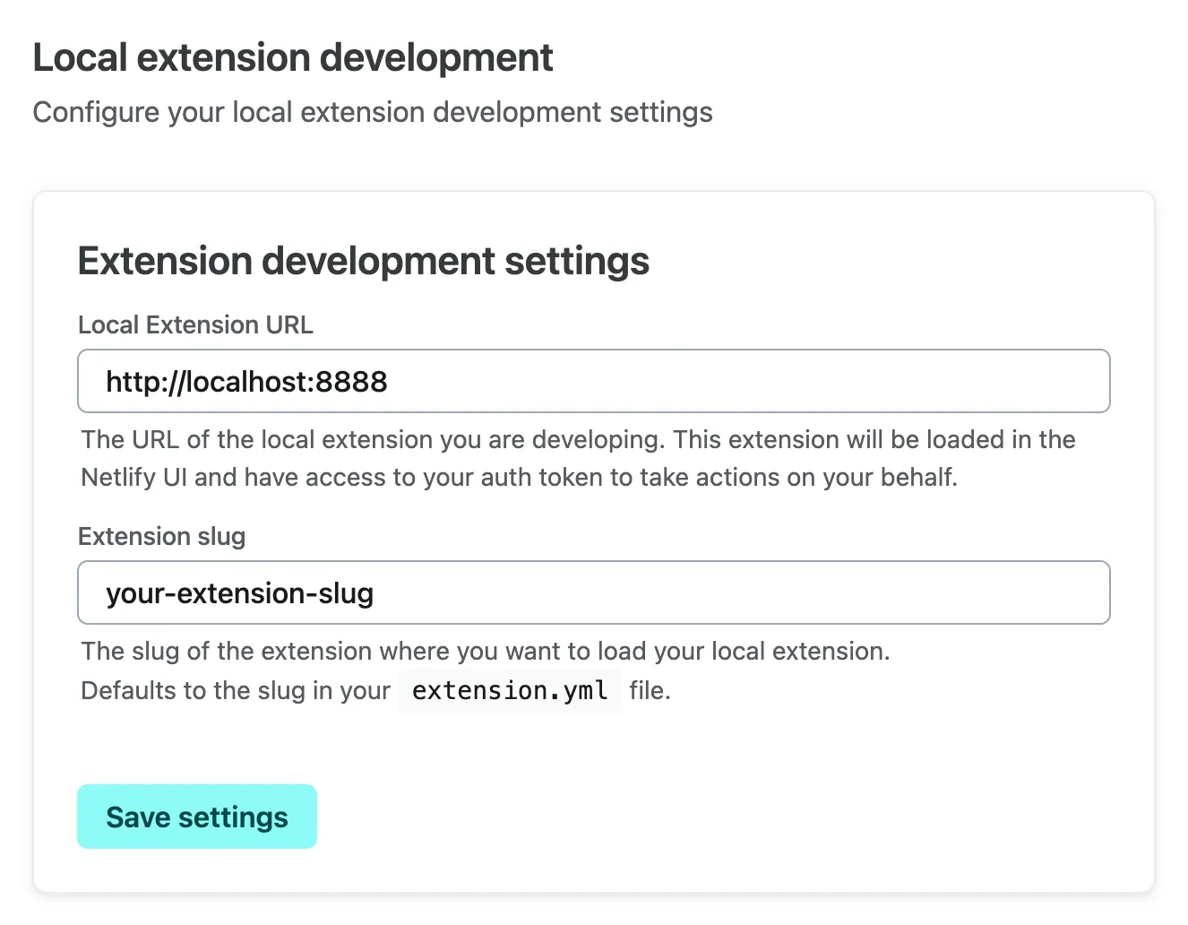

pnpm run dev --openyarn run dev --opennpm run dev --openThis command will start a local server and automatically open your browser to the extension development settings page in the Netlify UI. Only the authenticated user can access this URL.
On the local extension development page, review and save your settings. By default, the settings use the URL of your local server and the extension’s slug from the
extension.yaml
file but you can edit them as needed.The Netlify UI saves these settings in your browser’s local storage and will persist them across sessions, so only you will be able to access the local development version of the extension.
Learn more about developing locally with extension UI.

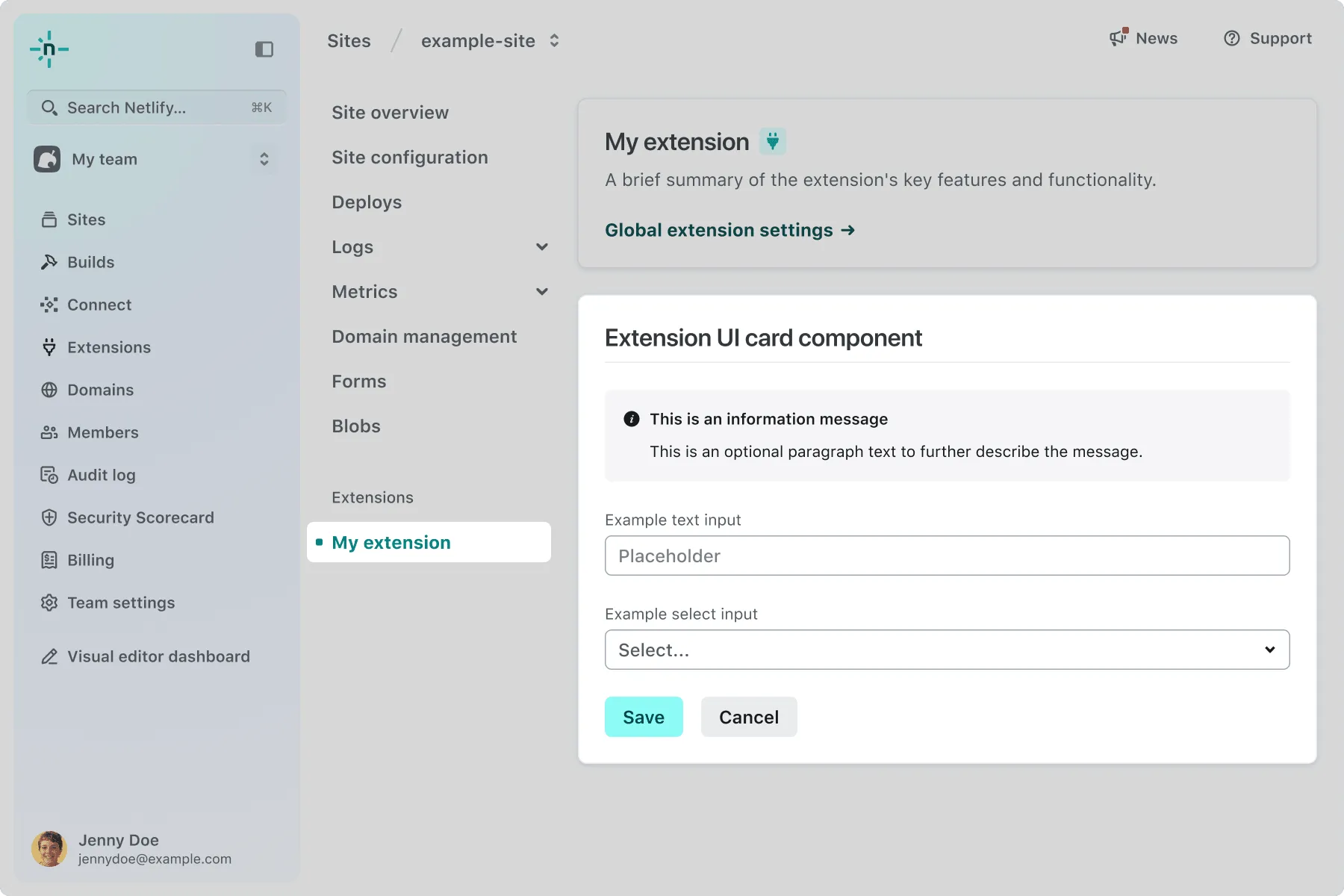

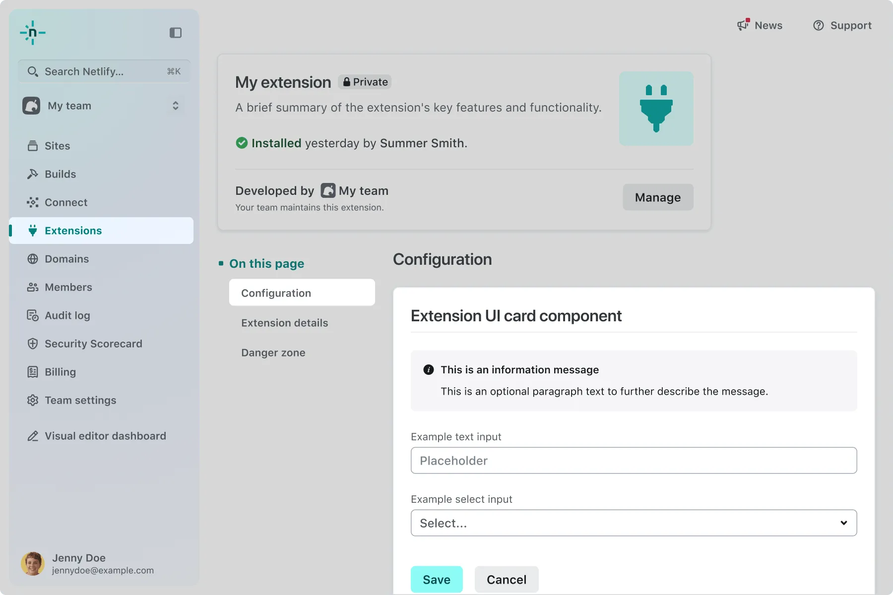

For example, if you selected the Extension UI
and Edge functions
boilerplate, you will find a configuration surface rendered:
on the extension’s details page under Extensions > [your extension’s details page] > Configuration
in a section listed under the top-level navigation for a project on your team
